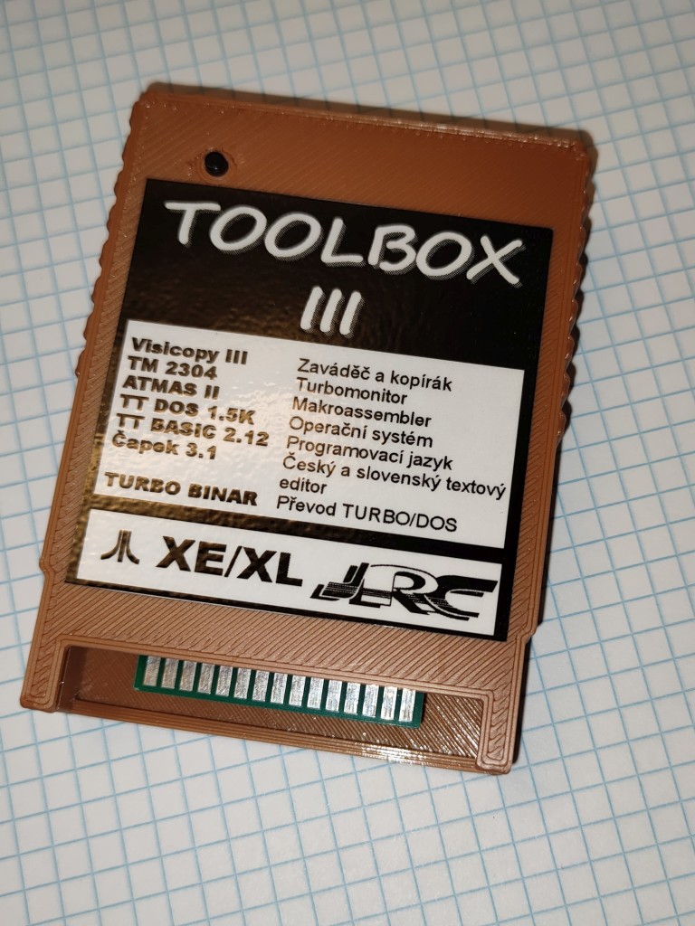

The interface allows you to read programs from a CD/DVD in a system similar to Turbo 2000. To make it easier to navigate the CD, a dedicated cartridge was created.

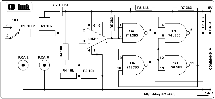

The original diagram presented by Igor Grambliček looks like this:

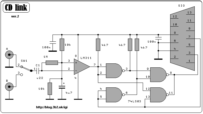

ans second version:
In the second version there is a small error in the description of the inputs of the operational amplifier circuit, which may be misleading, but the connections are correct...

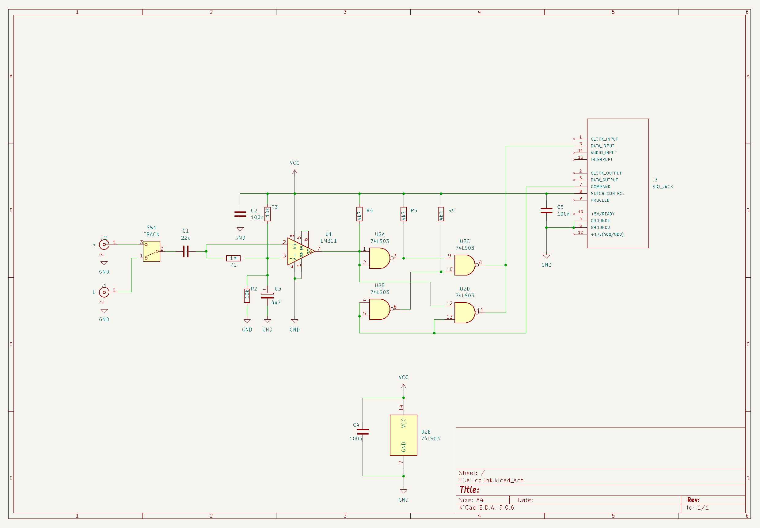

My version of the schematic redrawn in KiCAD:
Note: Use R1 = 100Kohm resistor instead 1Mohm because sometimes signal from CD is too low!

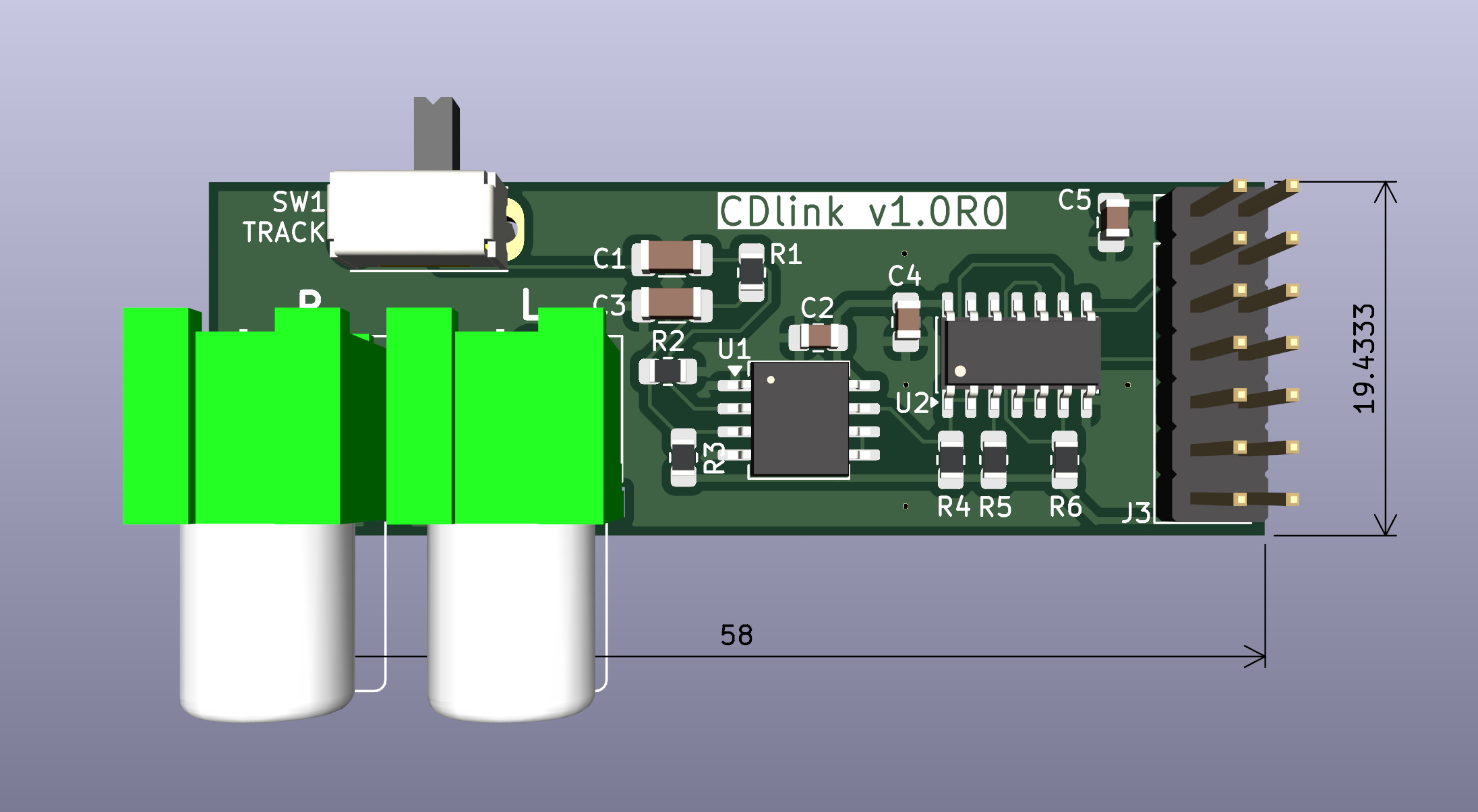

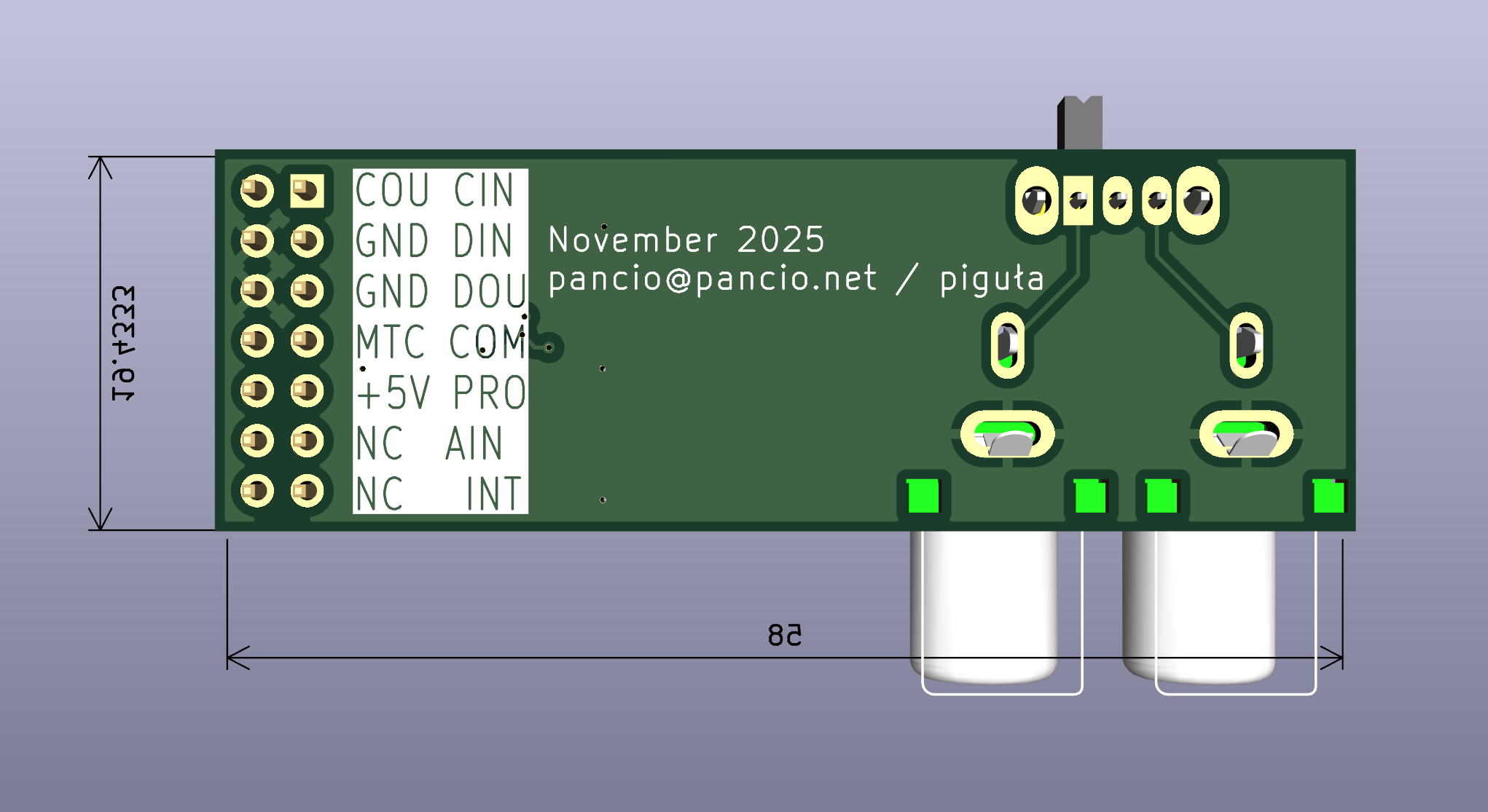

PCB visualisation:

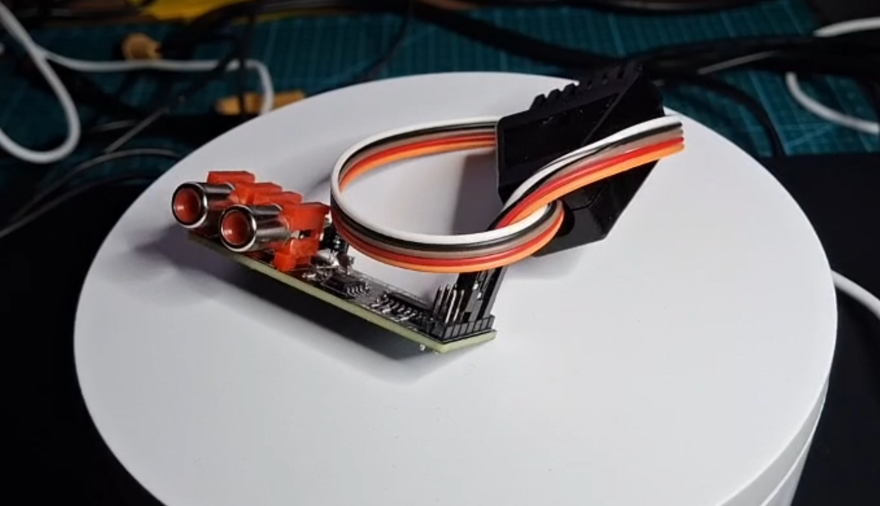

And final assembled by @Piguła MegaCD (CD-link):
It's worth noting that the interface can be used not only with CDs or DVDs—it can be used with any other audio source!

If you want to build cartridge with Tools - all required information you may find on: https://tnweb.tode.cz/atari-cartridge-t ... -visicopy/
