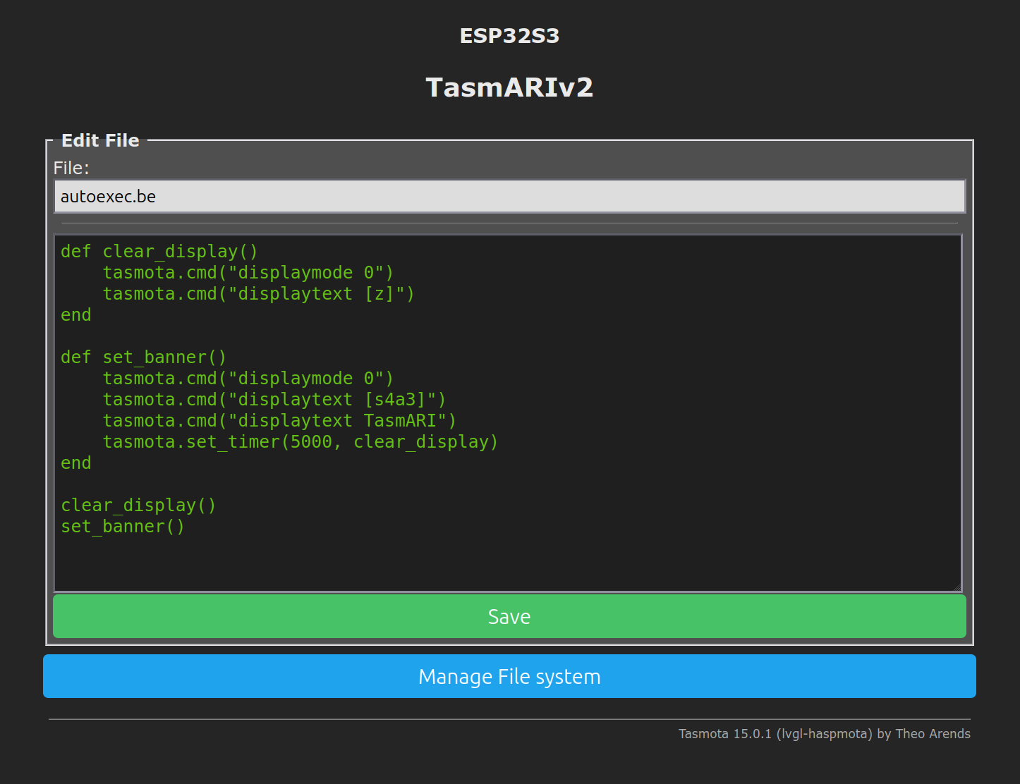

First, we configure the POKEY chip, set the transmission speed and allow data sending (:init). Then, we periodically send data in the form of the string 'Atari!' (:start) in a loop - POKEY SEROUT register contains byte to send.. The loop also includes an exit condition for the sending program, which checks for a POKEY interrupt for the SHIFT key (:exit). POKEY also triggers an interrupt after each byte is sent – ​​we use this to load the output register with the next byte at the appropriate moment (:wsent). If we did everything correctly, we can see that the SIO_OUT LED is lit (actually blinking quickly).
Now it's TasmotaOS's turn. We need to define a function that will retrieve data from the Atari:
ser = serial(18, 17, 19200, serial.SERIAL_8N1)   #RX18, TX=17
def read_sio()
    import string
    var msg = ser.read()
    tasmota.cmd(msg.asstring())
    print(msg.asstring())
end
Just copy/paste above to Berry console on TasmotaOS.
The program contains a definition of the 'ser' object of the 'serial' class and defines the transmission parameters and a simple read_sio() function that receives data from the serial interface (RX - GPIO18) and outputs it directly to the console screen.
Now we are ready to receive data on TasmARI. From console tool type 'be read_sio()' then observe results:
Voilà!
