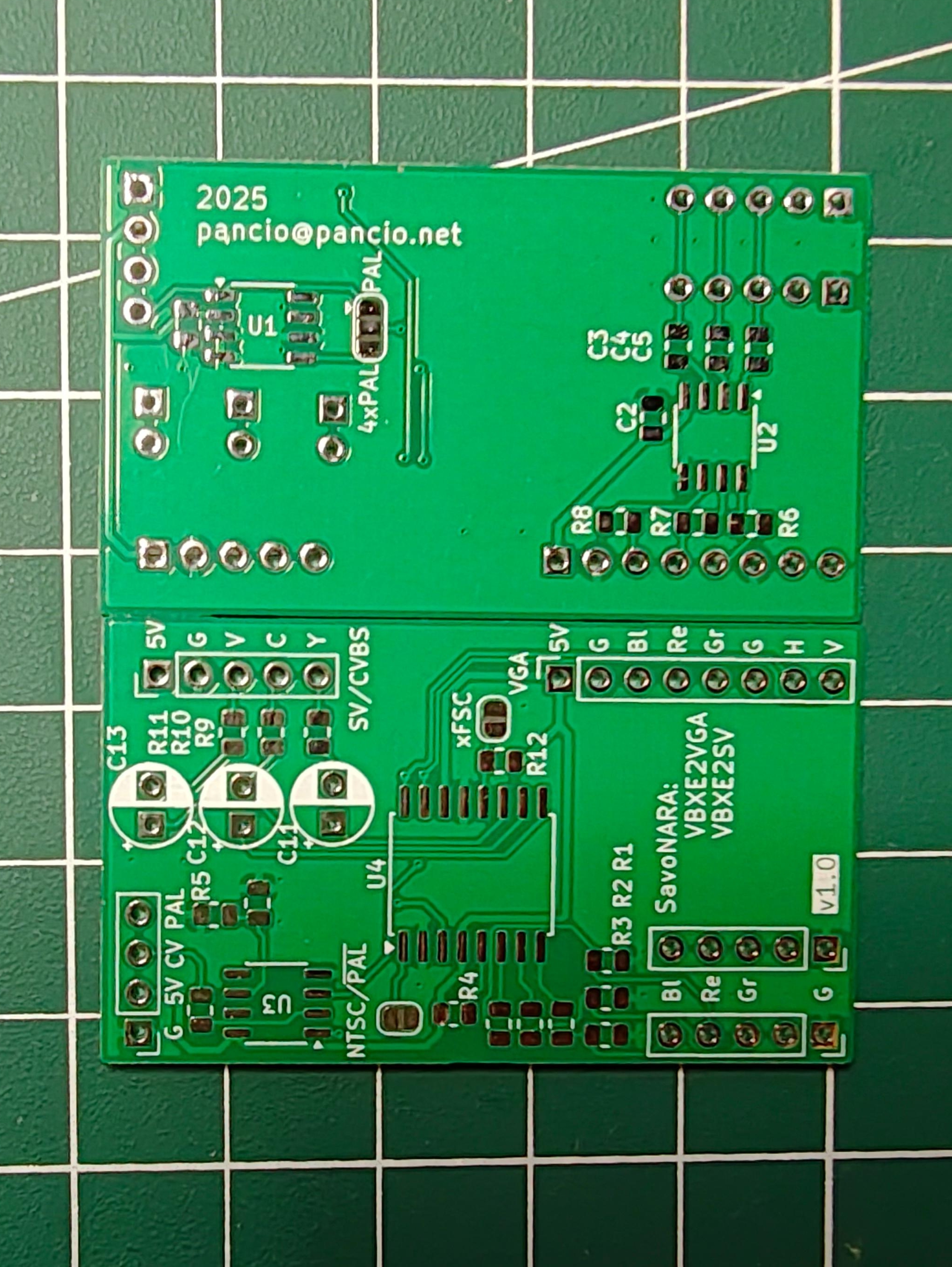

PCB layout
The PCB has dimensions 28.5mm x 49 mm and can be directly connected to VBXE RGB SLOT.:

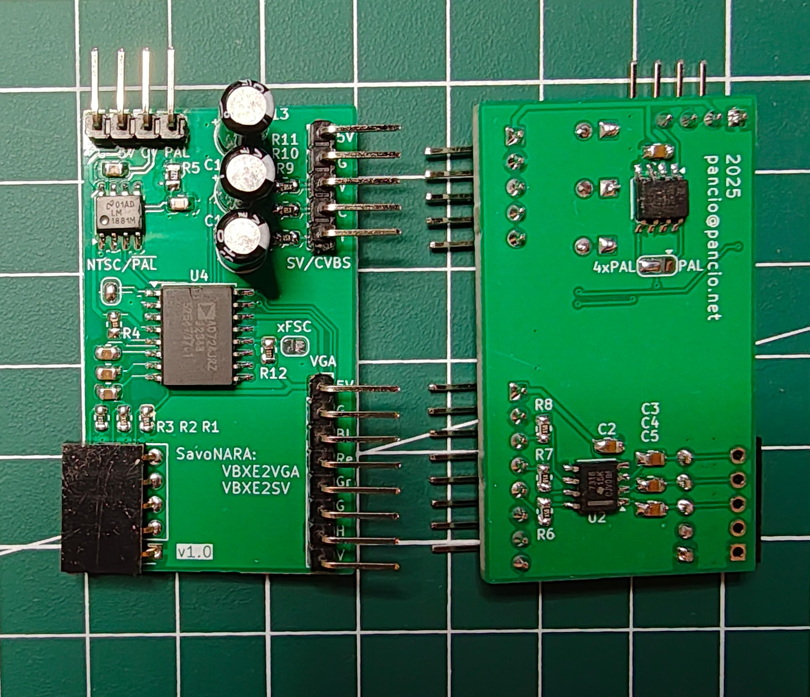

Assembly

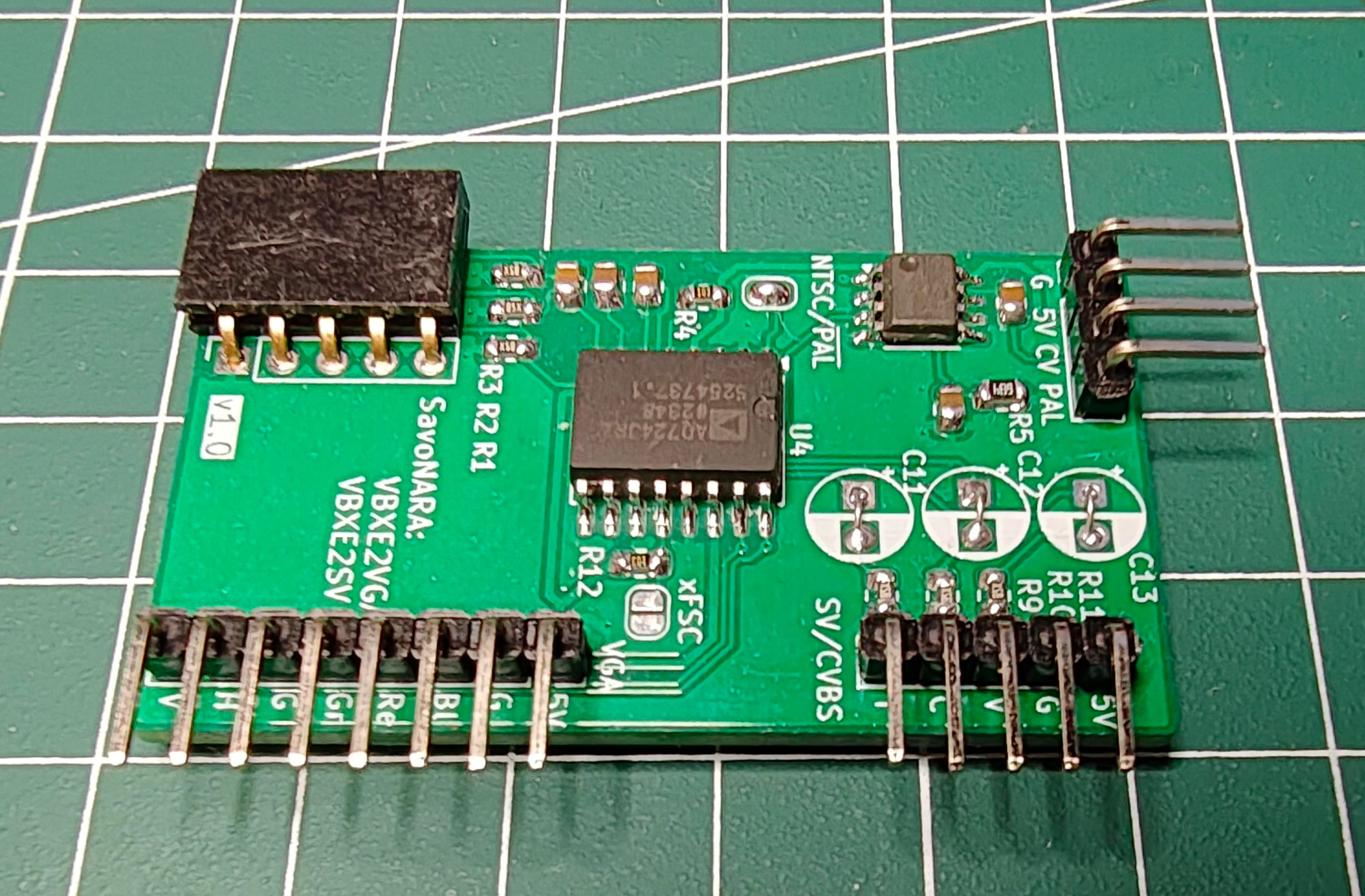

It is best to start assembling PCB with passive components. The board is relatively large, so there should be no problems. I used mostly solder pads for 0805 components, but it is much more convenient to solder 0603 components on them. In the next stage, we assemble integrated circuits and in the last stage, sockets/pin strips.
Completed and fully equipped board configured for PAL system:
One notice here regarding variant v1.0.x... there is no need to have big capacitors (220uF) on the output on SVIDEO and CVBS for PAL - it shall be replaced by short circuit by using wire - I leave these capacitor's footprints because I have no idea that these shall be use for NTSC or not. Probably not but I have no one NTSC TV at home for test:
