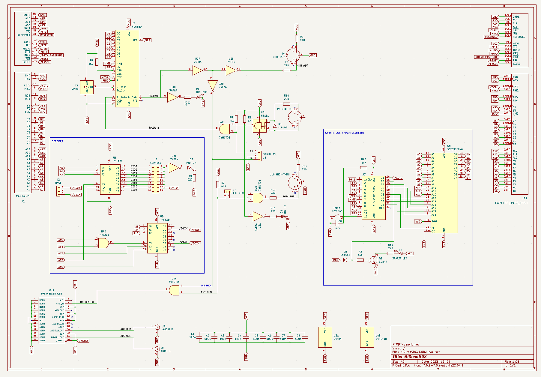

I would like to present new very usable variant of MIDIcar called MIDIcarSDX. The idea is to have MIDIcar ready to use without any external device, so I decided to add cartridge with SpartaDOSX equipped with PeBe's Player on CAR: device.
MIDIcarSDX Prototype PCB
MIDIcarSDX working prototype
