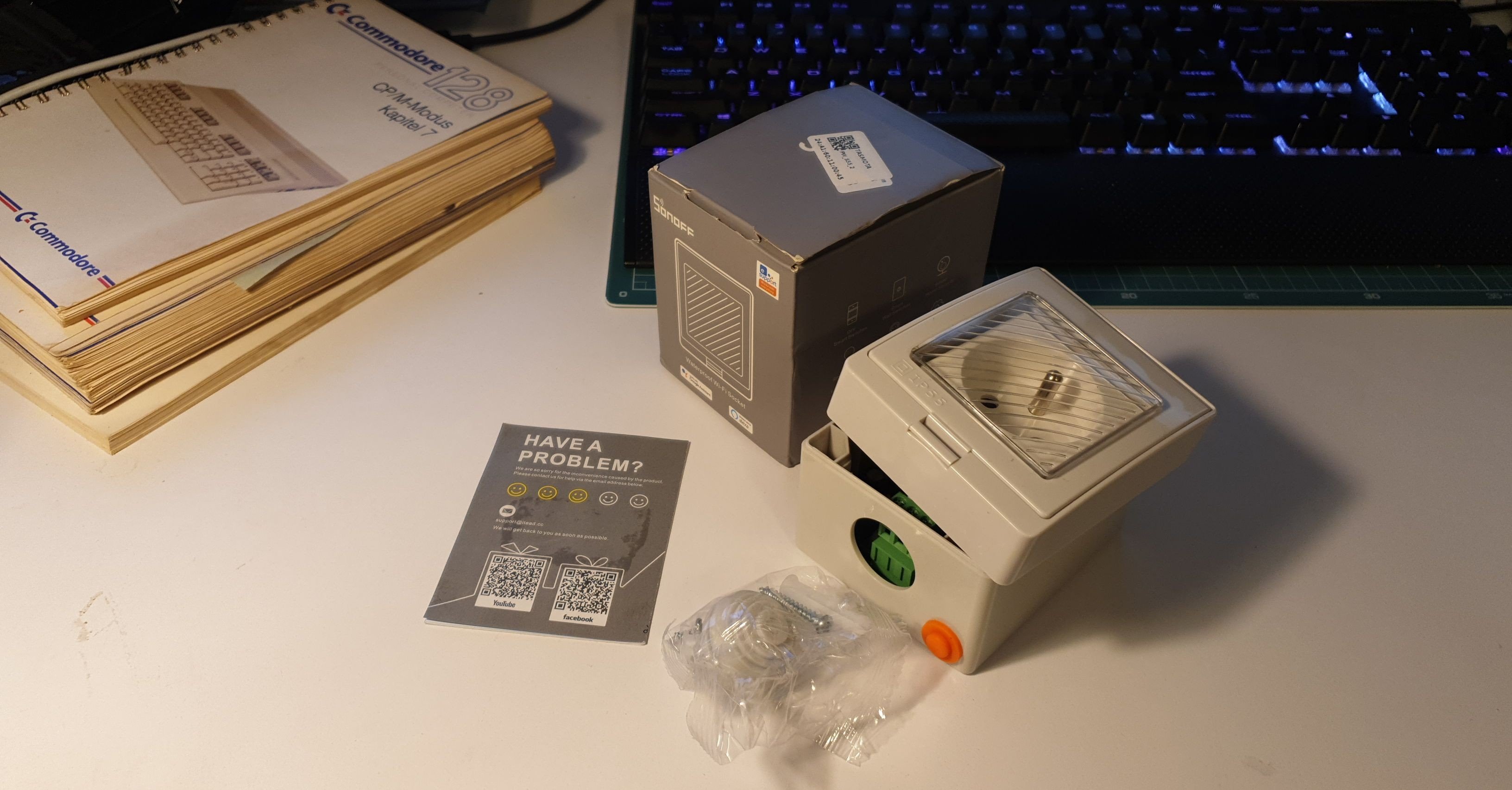

Today I'll show you how to prepare SONOFF S55FR Waterproof Wi-Fi Socket for Home Assistant under Tasmota environment. You may buy it on Banggood or Aliexpress, his price is abound 12$, so it's chip waterproof device in my opinion.
S55 unboxing
S55 unboxing

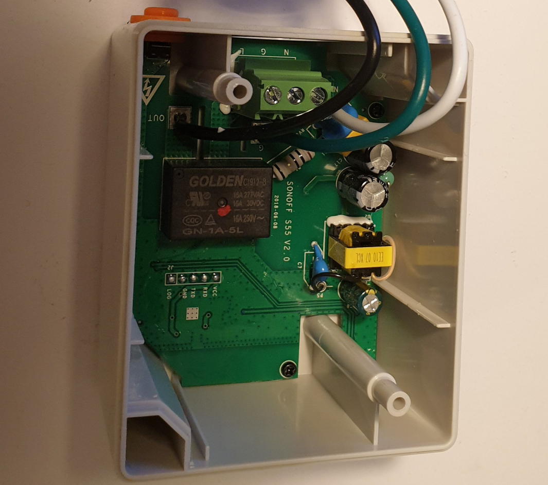

According to PCB variant which I received, flashing on-air (with tuya-convert software) is not possible any more. But don't worry. PCB was designed with all required PINs which are necessary to flash device with chip USB<->RS232 (TTL) converter:
Caution! ESP 8266/8285 don't like voltage higher than 3.6V. Your USB<>RS232 converter should work for 3.3V!
S55 PINs header
S55 PINs header

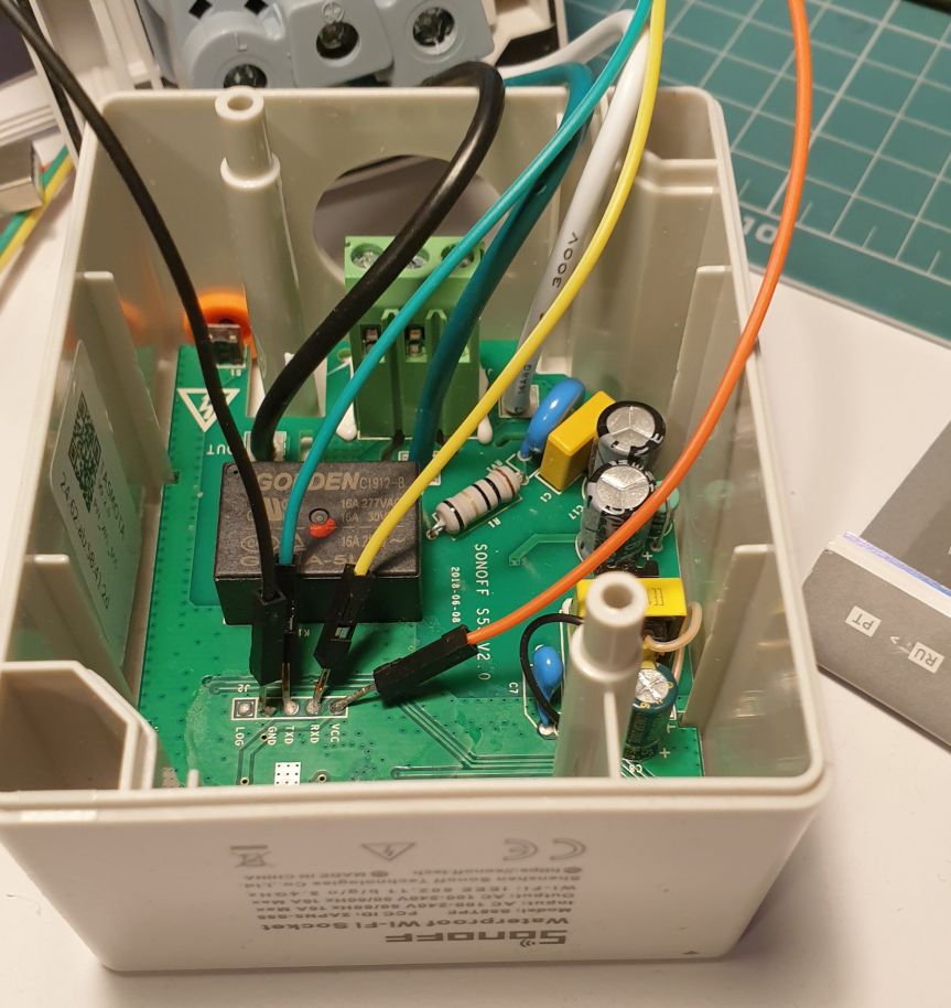

In case, there is no necessary to disassemble device... you may solder dupoints directly to empty pinout header.. just like that:
Connected dupoints
Connected dupoints

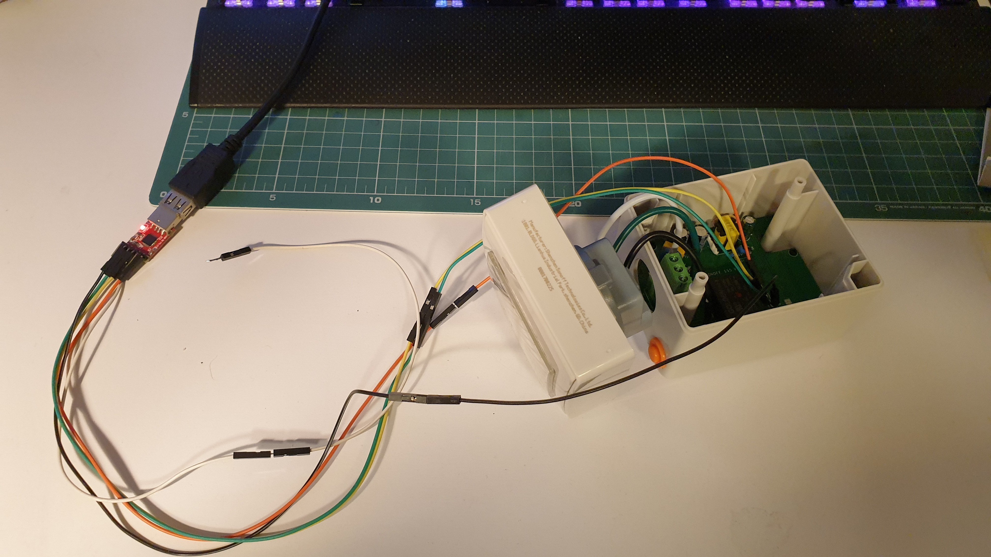

The finally, connect dupoints to USB2RS232 converter:
Ready to flash
Ready to flash
Wait wait... what about GPIO00 which is necessary to enable programming mode for ESP? Don't worry, you don't need to solder any more cable. Required signal is connected to switch placed on S55 case :-)

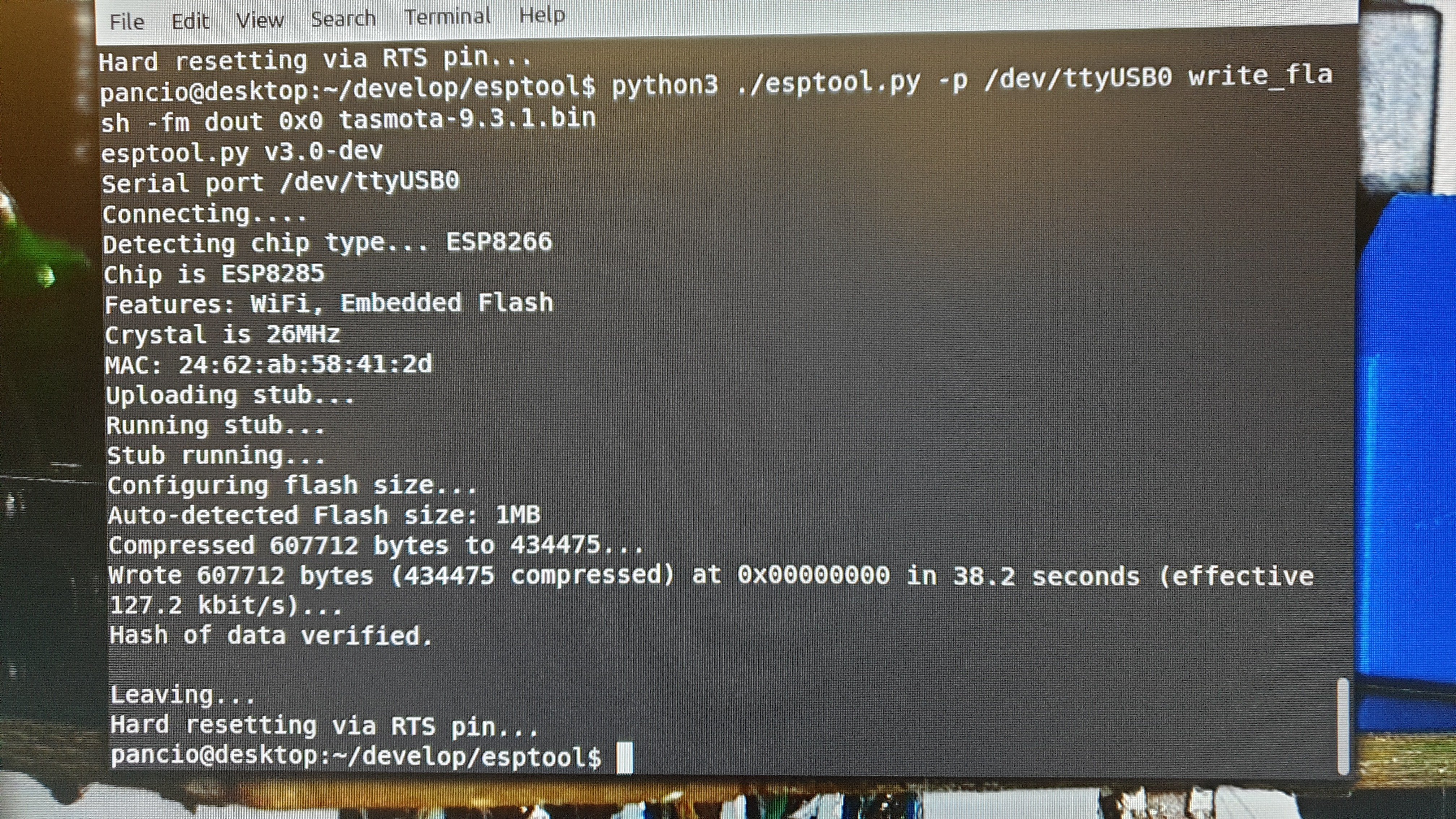

3. Flash ESP8285 by using command:
python3 ./esptool.py -p /dev/ttyUSB0 write_flash -fm dout 0x0 tasmota-9.3.1.bin
Flashing progress
Flashing progress
4. When finished, unplug USB2RS232 converter, plug it again and check that tasmota_xxxxx SSID is visible in your WiFi environment.
