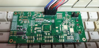

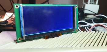

I'm glad to present the first GLCD 162x64 connected to Atari:
In order to connect GLCD I used both parallel ports - PORTB is a data bus and PORTA is for control signals. Actually I used only 5 signals, so rest may be use for other stuff.
Detail regarding wiring you may find in attached software.

Okay, showtime
First test:
https://www.youtube.com/watch?v=AIqA3mwTjPE
Second test:
https://www.youtube.com/watch?v=UfRcnNq25qg
Pseudo"white noise" and fill test:
https://www.youtube.com/watch?v=Y7OI5nXIfd0
Plot test: (point by point into memory)
https://www.youtube.com/watch?v=A8FGVxnLplQ
The last 2 tests are making into Atari memory and result is sending as whole frame to CLCD. If you are interested in how it's work, please analyse software...
