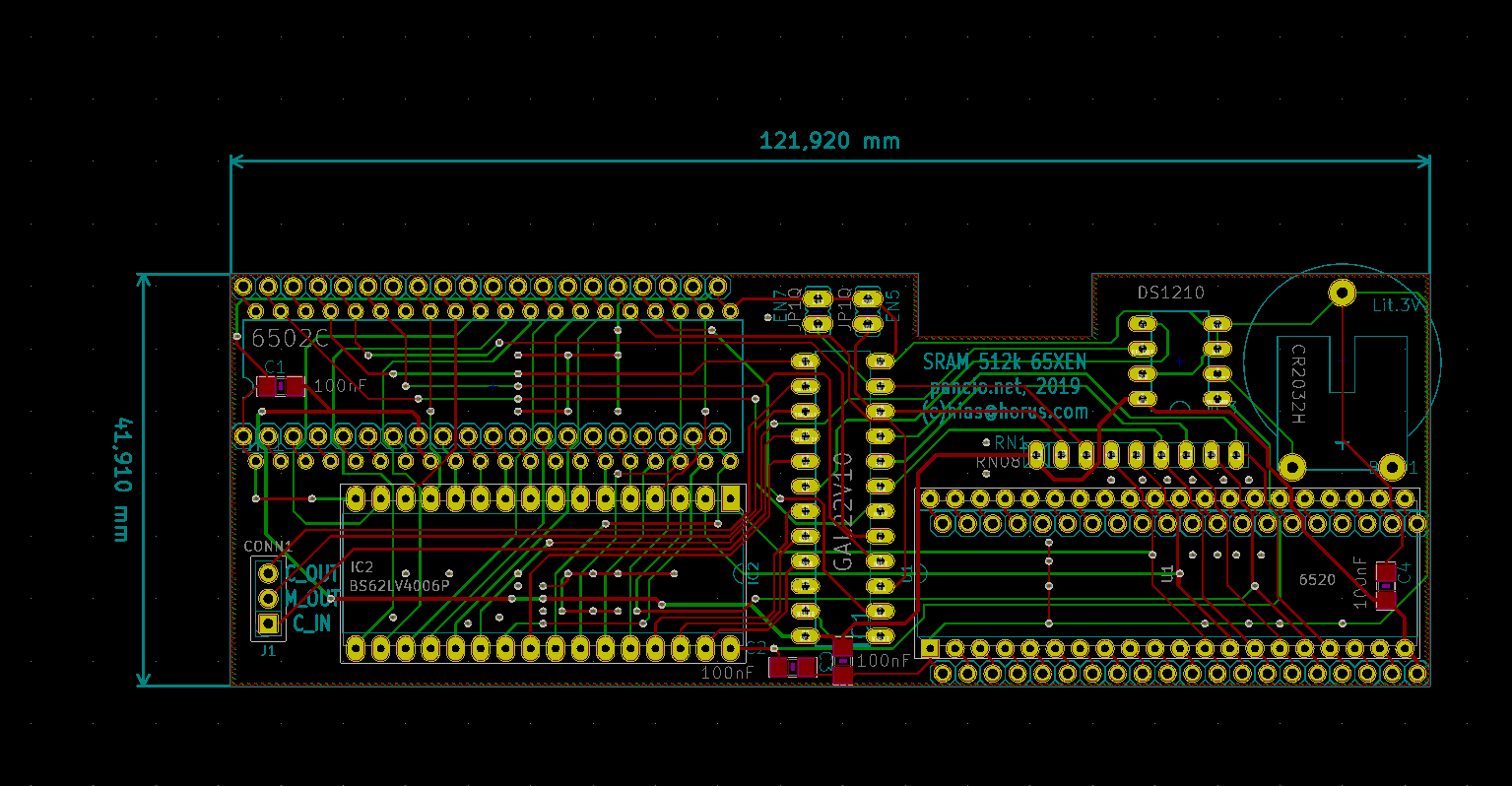

Matthias doesn't publish any PCB so I had little much work to do. At first I rearranged schematic in order to use piggy style assembly - I decided to use CPU as a base with full data and addresses buses. Additional I decided to place CPU and PIA on the same PCB as piggy. It's possible that in 65XEN both ICs are closer together. So, the schematic contains two piggys:

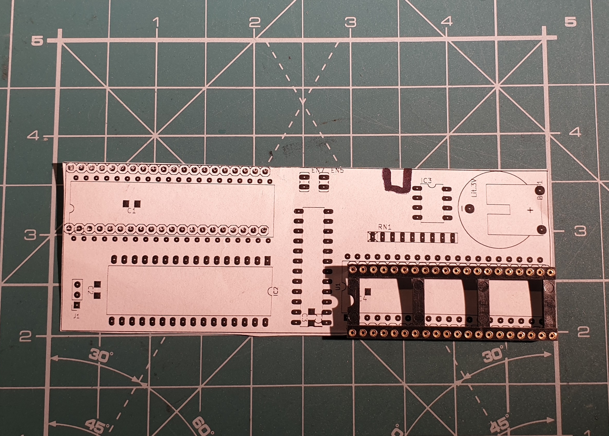

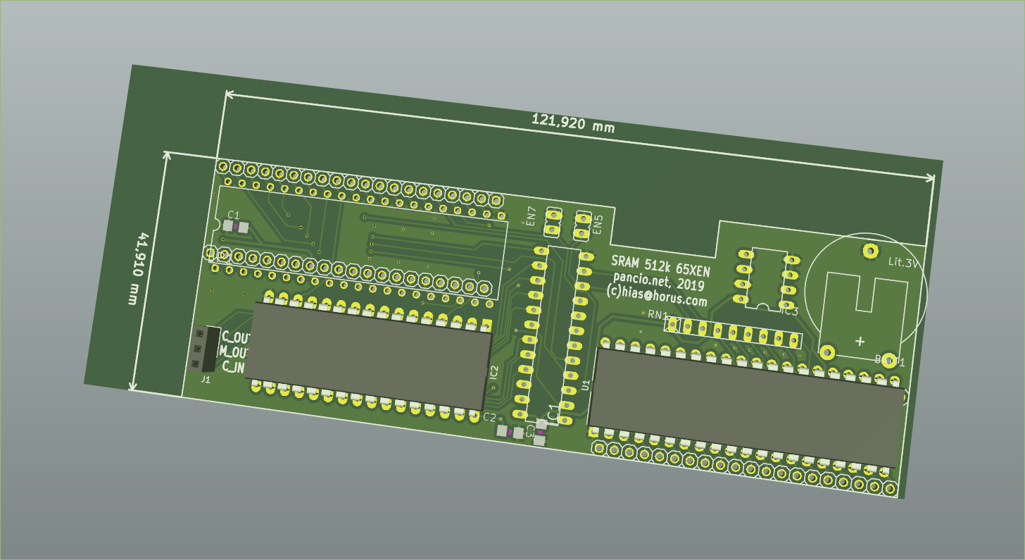

This mod is my first which I made with KiCAD. I can't work anymore with Autodesk Eagle because of it's limitations (PCB size, price). The KiCAD is so powerful as well. Matthias provided his project with Eagle format but KiCAD has very good import tool. Of course some corrections were necessary with used part on schematic. When I rearranged all wires I made a few prototypes on paper in order to match to Atari's motherboard.
SRAM 512k paper prototype
After a few trials the PCB was done:
SRAM 512k PCB KiCAD

SRAM 512k PCB KiCAD 3D

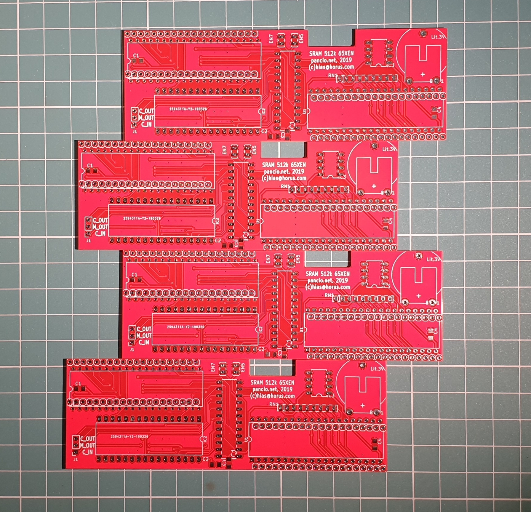

Well, regarding PCB manufacturing I may say only: never expect so much. On Polish market we have many PCB supplier but the price is rather terrible. I tried many China market company with rather good result for best price. This time I chosen JLCPCB because they have very good price with so short delivery time! (4 days! for production and delivery).
That's result:
SRAM 512k PCB RED
SRAM 512k PCB RED
The quality is very good so I will recommend this company for prototyping process

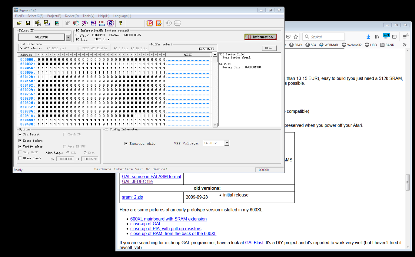

At first I burned GAL chip with new logical matrix from JEDEC file from Matthias's page:
XGPRO GAL22V10 programming

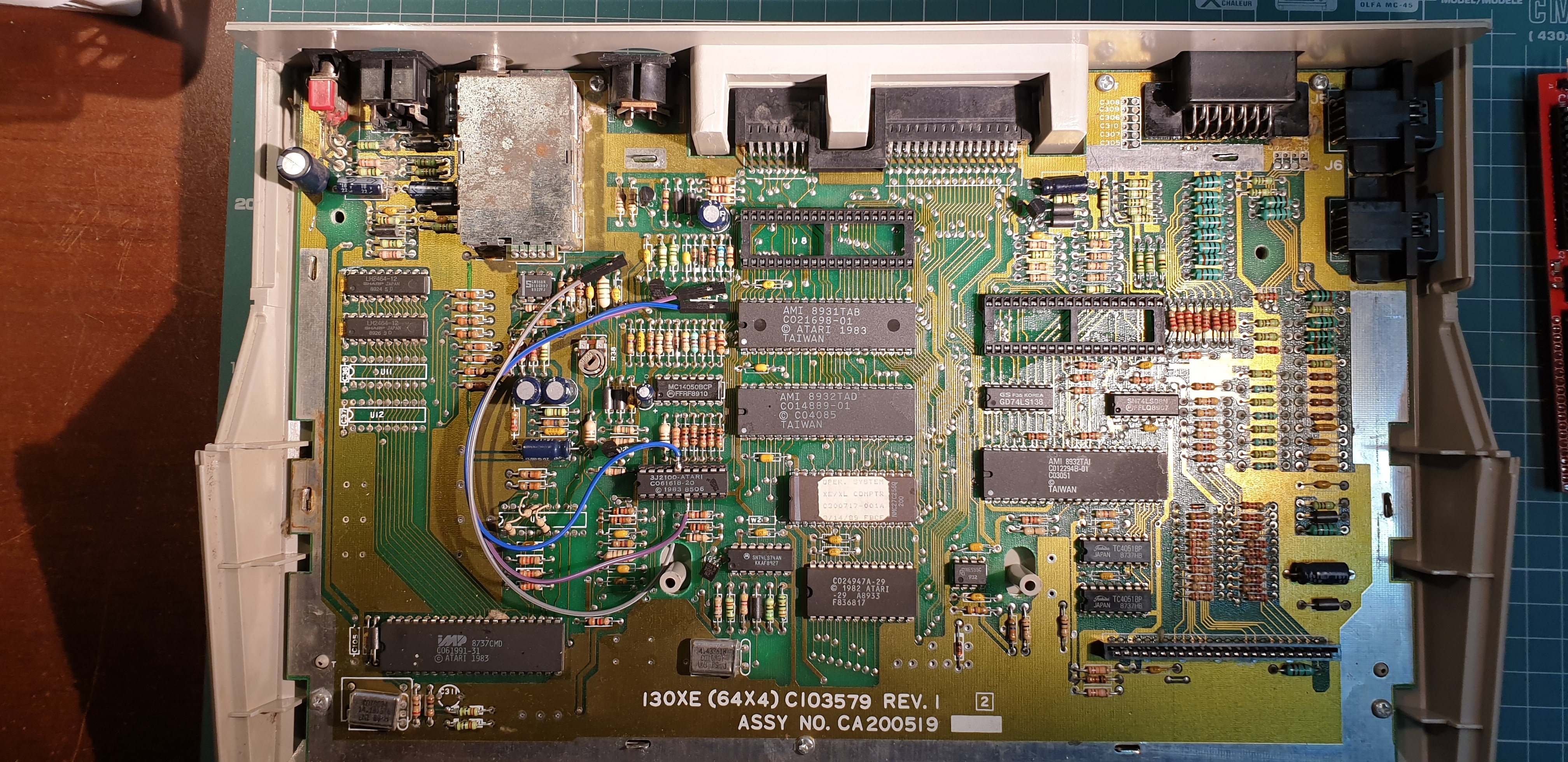

Next step is necessary if you have not socket ICs. In my case I desoldered CPU, PIA and small MMU and socketed. Pin 6 and 16 of MMU should be cambered to up and soldered to wired on memory board. The same with 16 pad of MMU socket (see schematic):
Atari 65/130XE socketed and prepared for extension

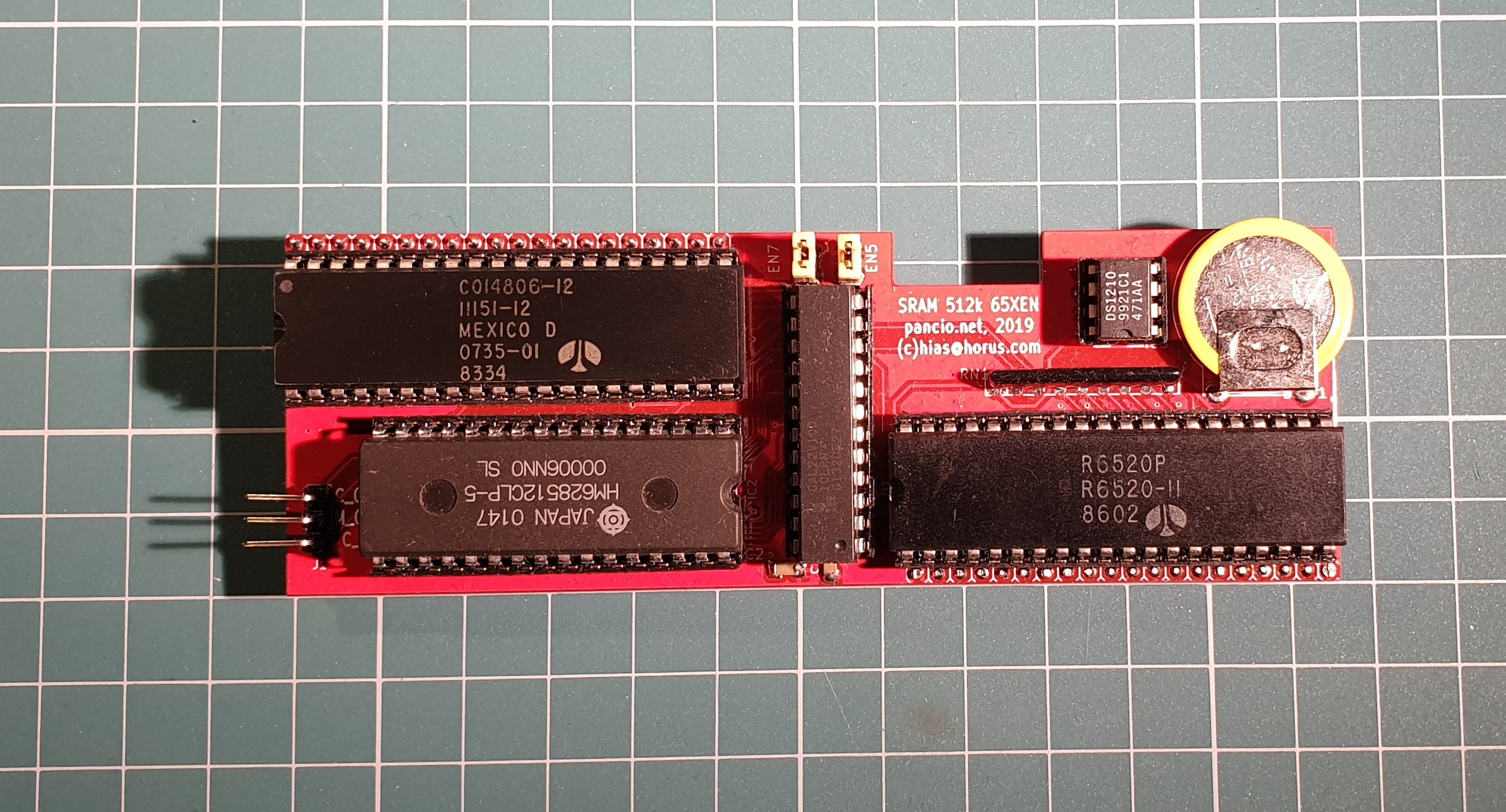

then assembly all on extension board:
SRAM 512k PCB assembled

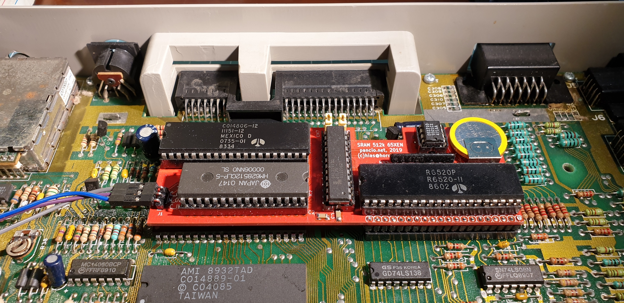

and finally result:
SRAM 512k on motherboard. Final result
