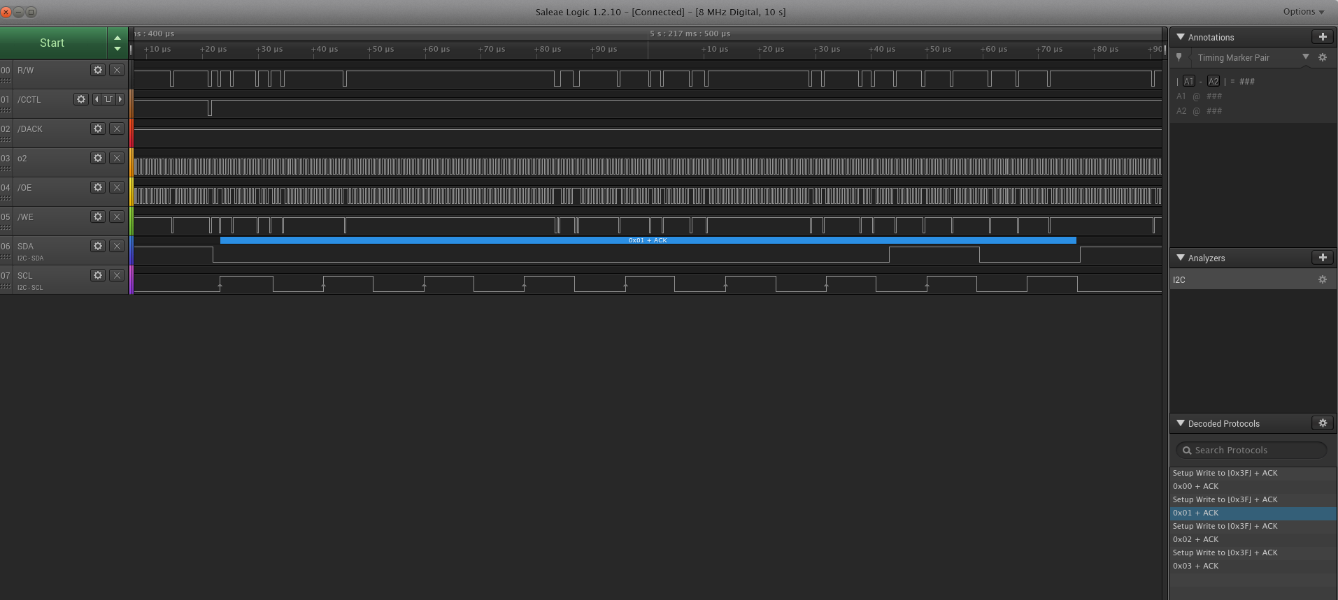

As you mentioned, the /RESET line is open drain and for normal work you need to pull-up it to Vcc thru resistor but I suppose your microcomputer system has this line pulled-up in other place. Are you sure that PCF8584 RESET pulls the line down? It's input pin, so probably PCF is damaged. I had issues run PCF in 6800 mode so I decided to use Intel mode.. You should analyse your address decoder/discrete breakout for /RD /WR /CS to be sure that time restrictions are ok e.g. using logic analyser. For example I added screenshot with timing sequence with Atari, PCF8584 and PCF8574 which may be helpfully. In case /CCTL is connected to /CS (from address decoder), O2 is clock signal from Atari (1.79MHz), Rest signals you know...

I will double check my reset line circuitry. I also took the PCF8584 out of circuit and only hooked up VDD & VSS and then connected the RESET pin to VDD using a 4.7k pull up resistor, and still had the RESET pin registering as low. I'm going to order a new chip, just to make sure that's not my problem.
Thanks for the timing diagram. I also have a Saleae logic analyzer, so I will wire mine up the same as yours, and check it out.
