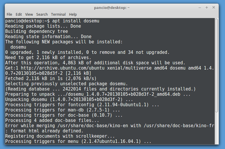

First, install 'dosemu':
apt install dosemu
<Important>
Since Linux Mint 21, dosemu package is not distributed anymore.
Please use PPA method:
sudo add-apt-repository ppa:dosemu2/ppa
sudo apt update
sudo apt install dosemu2
</Important>
DOSEMU install process

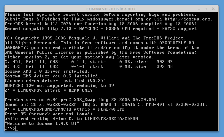

now you have fully working DOS envt. You may try to use it by type: 'dosemu' in terminal:
DOSEMU window
DOSEMU window
Hurra! DOS emulator is working... so let's run PALASM software. Type simple 'exitemu' to quit from DOS. Next, you should download PALASM archive and place uncompressed folder it into '~/.dosemu/drive_c'. I downloaded ZIP archive from:

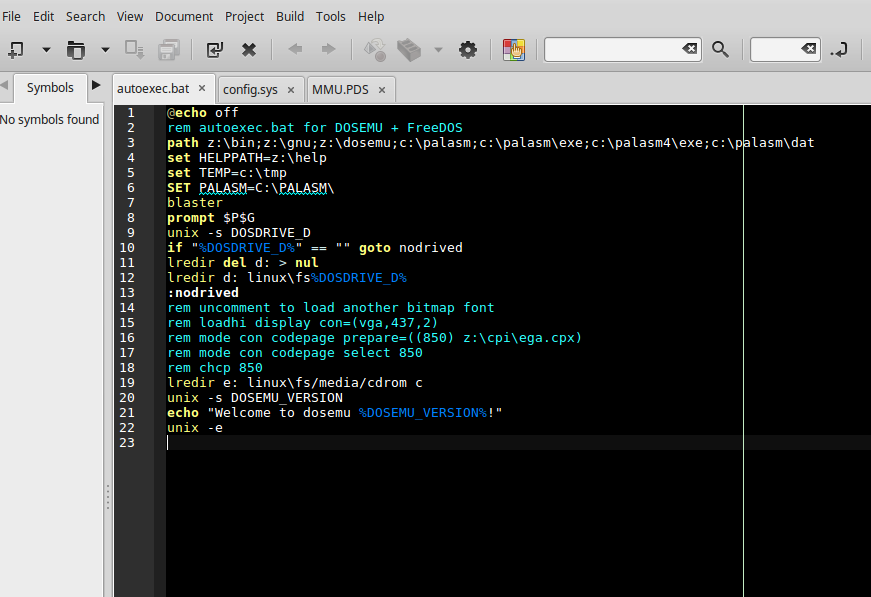

1. Edit AUTOEXXEC.BAT file and add:
path z:\bin;z:\gnu;z:\dosemu;c:\palasm;c:\palasm\exe;c:\palasm4\exe;c:\palasm\dat
SET PALASM=C:\PALASM\
AUTOEXEC.BAT edit
AUTOEXEC.BAT edit

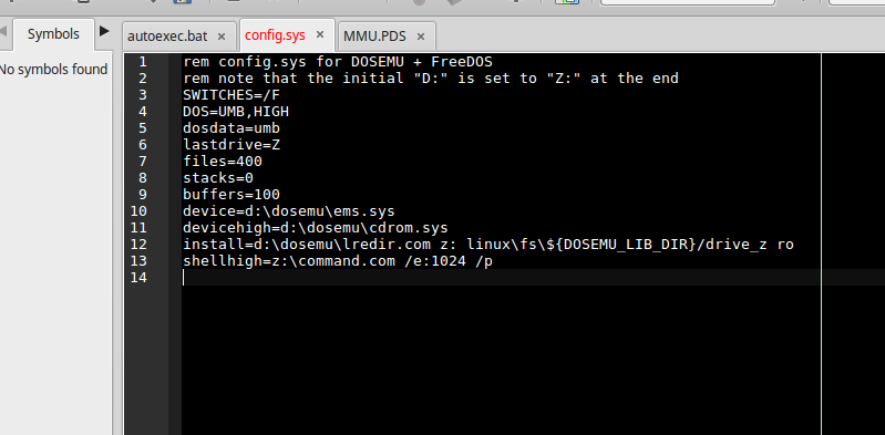

2. Edit CONFIG.SYS file, change FILES and BUFFERS variable:
files=400
buffers=100
CONFIG.SYS edit
CONFIG.SYS edit
Done!

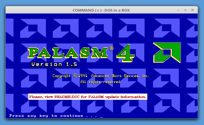

PALASM start page
PALASM start page

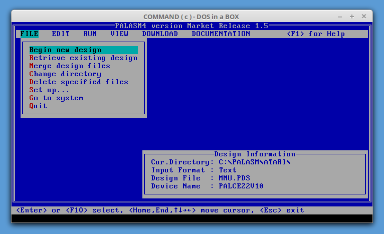

PALASM menu
PALASM menu
That's all! We have working very old software but still desirable for modern projects :-) Have fun!

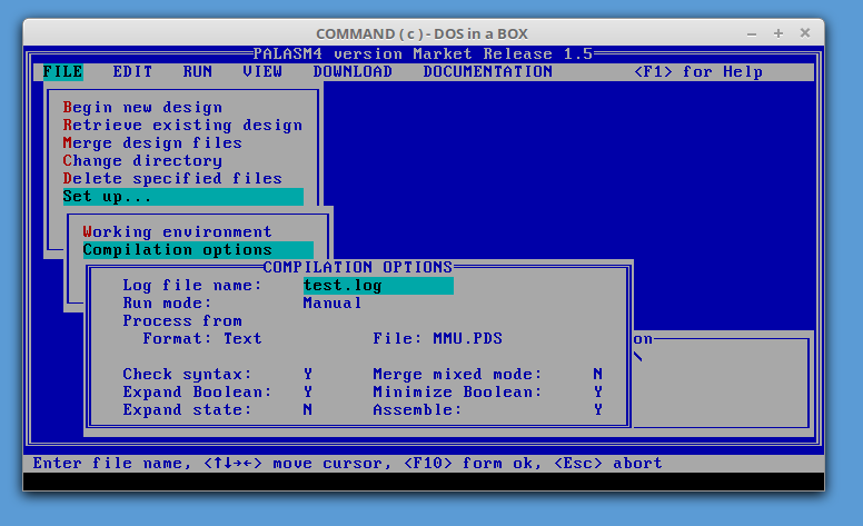

During compilation some source files e.g. Hiaasoft's 512k SRAM extension for Atari XL/XE GAL source file I've got a couple of errors. The reasons was so trivial.. but little tricky: some compilation options was not optimally. Those options should be set as shown:
PALASM compilation options

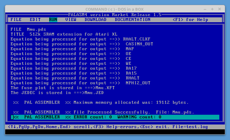

Now compilation will finish with success:
PALASM compilation result
