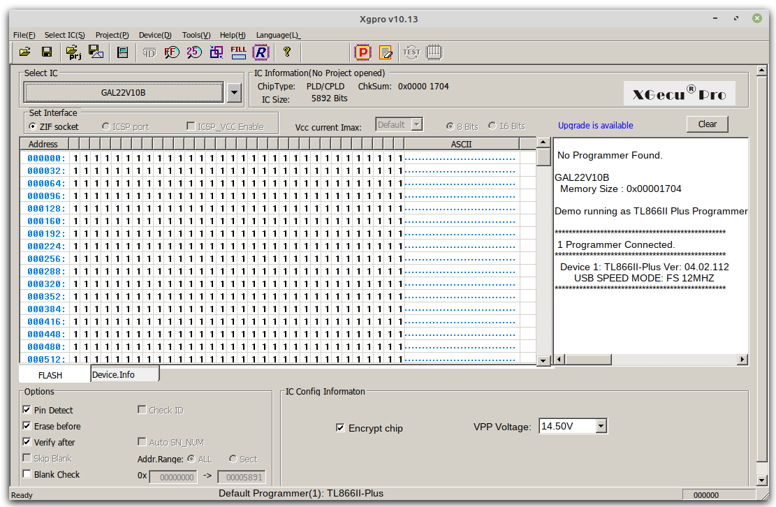

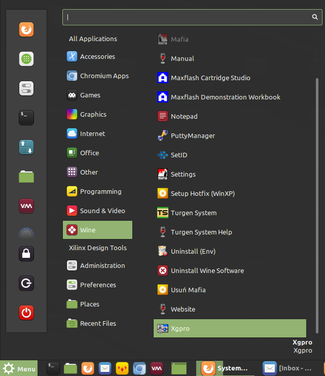

Wine
If you want the same MiniPro experience under Linux as you have under Windows then Wine is probably the way to go. The steps are:
  • Install Wine if required.
  • Extract the contents of the XgproV10xx_setup.rar and run wine ./XgproV1013_Setup.exe or double click from file manager app. Note that the application should install fine, but you won't be able to talk to the device just yet.
  • Download setupapi.dll from this git repository and copy it to the same location where you installed Xgpro. This might be somewhere like ~/.wine/drive_c/Xgpro or similar.
  • As root, create /etc/udev/rules.d/50-xgpro.rules and add the following:
    SUBSYSTEM=="usb", ATTR{idVendor}=="a466", ATTR{idProduct}=="0a53", GROUP="plugdev", MODE="0666"
  • Restart udev by running
    udevadm trigger
If everything has worked you should be able to plug the TL866 II Plus in and start up the application from Wine.
Wine - Xgpro
Wine - Xgpro
Xgpro under Linux
